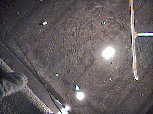

It was just a replacement,take the old one out smooth out my sand and drop it in, no extra's just the vinyl. Tried a few night shot's maybe you can see better, the brush in the pic's is for scale and it is 3'. Thanks again

OK. I posted your pictures. I'm not sure what to make of them.
A black liner with no pattern is going to make such surface defects more visible. But since it's a purely visual defect, rather than a functional one, I imagine that the contract you have with your contractor is likely to determine your options.
I don't know if that's acceptable work in your area, or not. I do know -- purely from having swum in a number of vinyl pools -- that such surface irregularities are common in my are. But you don't see them, usually, with a patterned liner.
