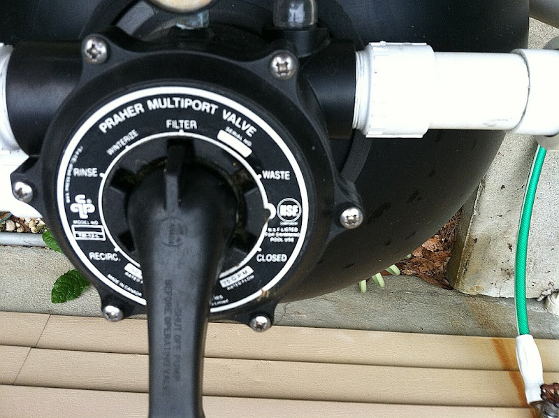

    i have some pics of the equipment i have and the white clouds that formed
    it says its a 30" filter, i would imagine it is sand

    Here are your pics.
    One caution: do NOT drain if ground surrounding your pool is wet. It looks like you are on level ground, which means water could gather under your liner and lift it, if your drain much from the pool.
    pool
    equip
    valve
    multiport
    filter label
