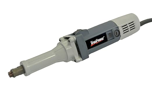

    You'll need a die grinder to clean out, and groove, the crack so you can refill it with the epoxy. The 2 grinders below are both cheapo models. The first one used to be sold under the Makita brand, and I used one for years. I currently have the second one, sold under a General Tool brand. But, I've found them adequate for the light duty I've given them. The
    TruePower Long Shaft Electric Die Grinder @ Amazon
    1/4" Heavy Duty Portable Handheld Die Grinder Sanding Polisher Tool @ Amazon

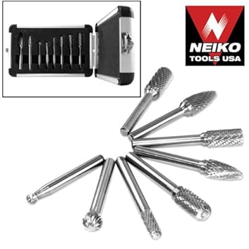

    These 1/4" shaft carbide burrs should also do the job for you. There are some cheaper ones, but they aren't as well rated:
    Neiko Tools 8-Piece Double Cut Carbide Rotary Burr Set @ Amazon
    Astro Pneumatic 2181 Double Cut Carbide Rotary Burr Set with 1/4" Shank @ Amazon
    Of course, you can go pro-grade, and get SGS burrs and a Dewalt die grinder -- but you'll spend $150 more, and probably not get value, unless you have a machine shop at home. My burrs are mostly SGS, but I bought them 20 - 30 years ago, when there weren't reasonable quality lower-priced alternatives.

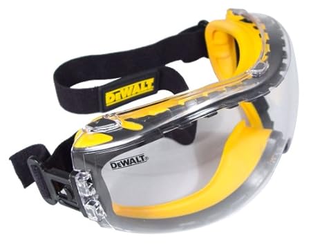

    If you do get the grinder, practice on some similar plastic FIRST. If you press hard, you'll burn, rather than cut, the plastic. Also, plastic tends to clog the burr, so have a carbon steel utility knife handy to clean with. Hold TIGHT to the grinder -- and use a light touch when grinding -- the burr can 'catch' and jerk you or the pump around. Finally, always, always wear safety glasses. This tool WILL put grindings in your eye otherwise, and plastic or aluminum filings are difficult to get out.
    BUT . . . learn to use one of these, and it will save you much time and money. Rusted nut? No problem -- grind it off. Tile piece almost fits -- no problem: clamp it and grind it. These burrs will grind hard plastics, all metals except lead, most ceramics. But, SAFETY GLASSES:
    DEWALT DPG82-11C Clear Anti-Fog Dual Mold Safety Goggles @ Amazon
    Dewalt DPG55-11C Clear Anti-Fog Protective Safety Glasses @ Amazon
