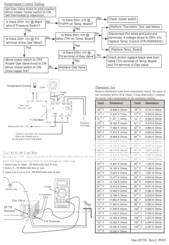

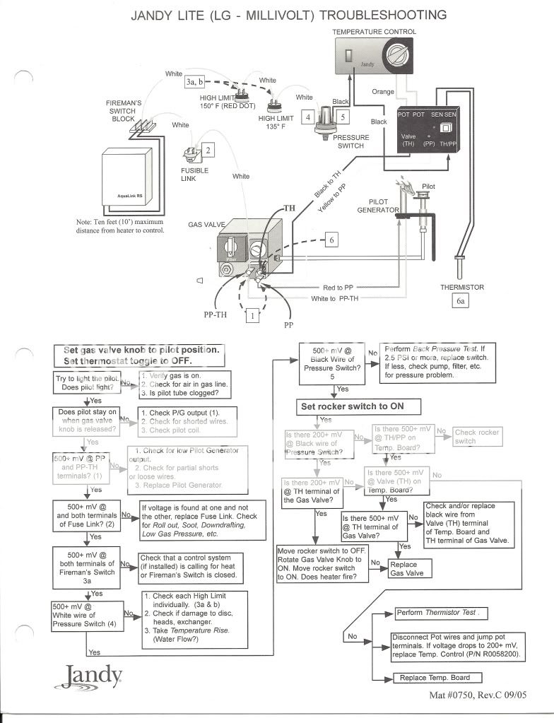

    If you have the manual with the troubleshooting directions, you can 'jump out' the various switches to see which one is bad and only have to replace that part.

    Here is an LG-millivolt, if you have electronic ign (LD), i have that as well.
    If you can run a volt meter, you can try troubleshooting. A very benign test is to check the resistance of the temp sens. This is the trouble a lot of times.
    If you don't feel comfortable with this, DON'T CONTINUE.
    While it's not rocket science, it still requires a certain amount of safety.
