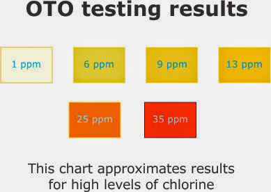

    A link that may be helpful which shows how to interpret chlorine readings that are higher than the OTO chlorine tester can differentiate. http://pool9.net/oto-chart/
    (Your K2006 will be able to read chlorine readings way higher than 5ppm which is the limit on an OTO test kit.)
